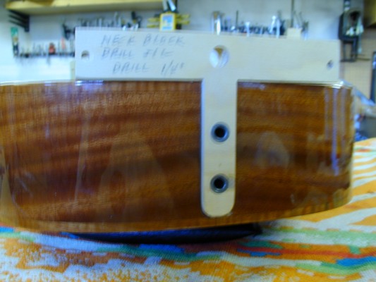

Here's a photo of the jig I use that fits right into the mortise and has two drill guide bushings to locate the holes the same every time. Excuse the fuzzy photo, but you get the idea.
Hank Mauel
